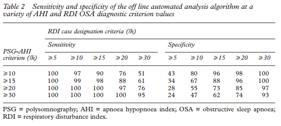

The golden standard for apnea screening is PSG, which measures the AHI (apnea-hypopnea) index. Several studies has shown large correlation between AHI and ODI/RDI (oxyhemoglobin desaturation index, oximeter-derived respiratory disturbance index).
ODI/RDI indexes can be effectively obtained from Pulse Oximetry at home.

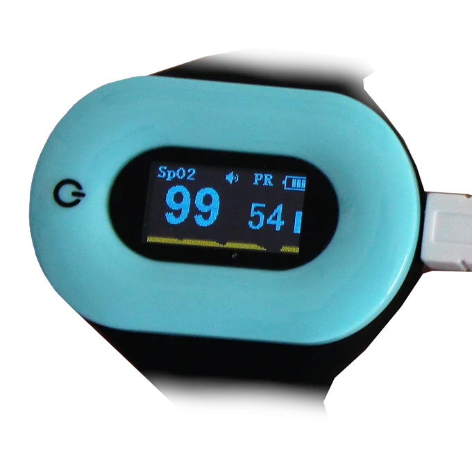

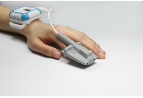

Sleep as Android supports StressLocator pulse oximeters. Simply pair your StressLocator device, enable Settings – Wearables – Pulse Oximeter, put the device on your finger and start sleep tracking.
In the morning Sleep as Android determines your RDI with the related severity scoring. Score over RDI >15 per hour is considered as a significant warning sign and visiting a sleep lab is highly recommended.
