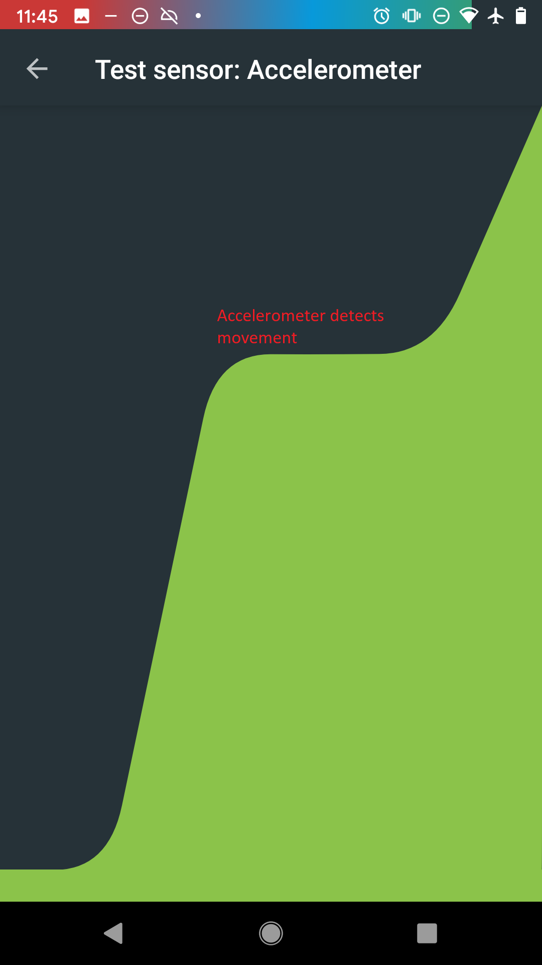

5.1. Accelerometer testing
Accelerometer sensor is a system sensor, so there are rarely issues with this sensors.

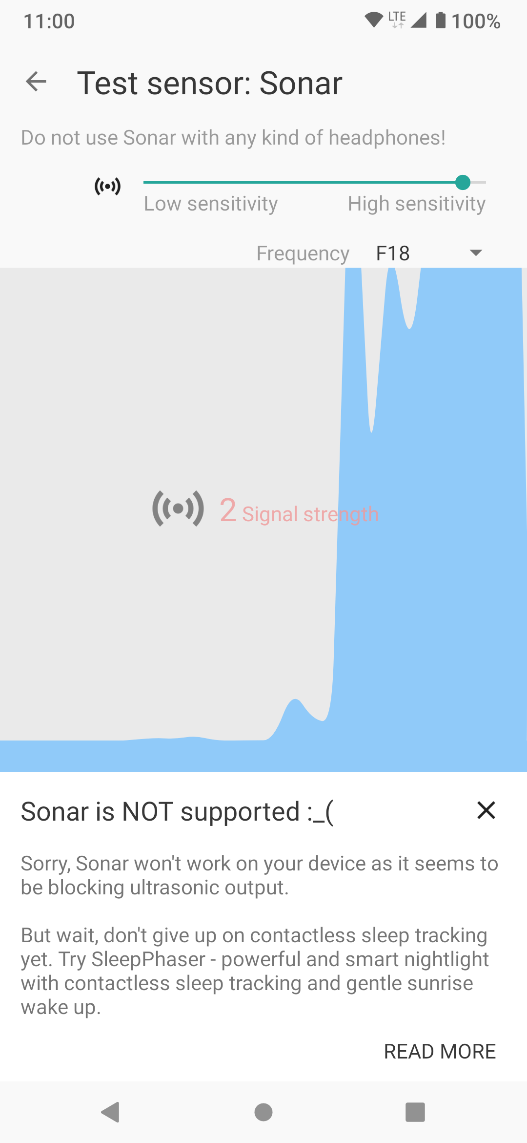

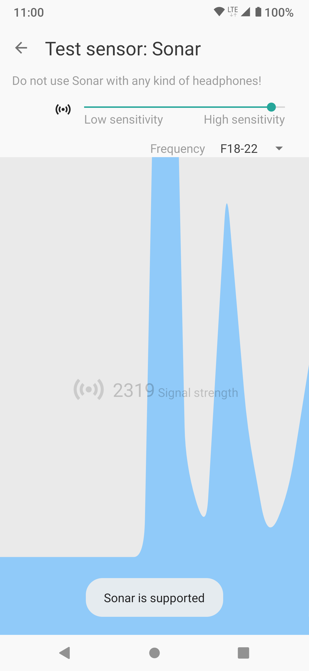

5.2. Sonar testing
Sonar testing screen allows you to test the capability of your phone to produce the signal, the strength of the sonar signal, and also changing the sonar properties - the frequency and the sensitivity.
Sonar testing screen is always labelled as "Testing sensor: Sonar".
The slider changes the strength - the higher the sensitivity, the higher the strength
Choice of different frequency of the sonar signal
The number you see in the middle of the screen is strength of the signal - the higher th better.
